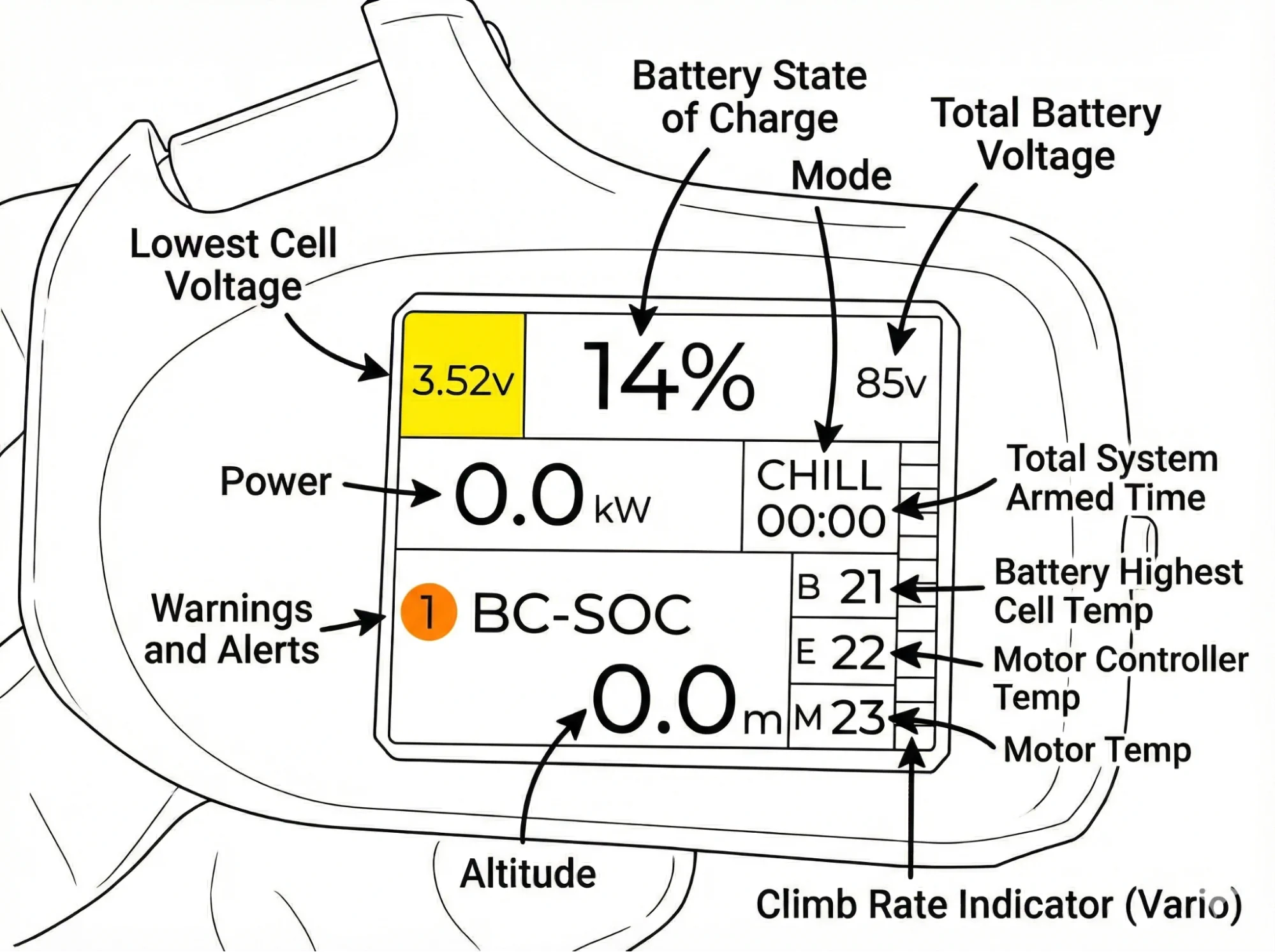

  1. We can study the hand controller telemetry data displayed on the screen so you can get familiar with it.
  2. The power is shown in the middle left side of the screen and you can see how it changes under different throttle levels it is shown in KW (kilowatts)
  3. In the top is the SOC (state of charge) of the battery as a percentage. In the far left you will see a small number ranging from 2.5-4.2V. This is the lowest cell voltage in the battery pack. The top right corner shows the total system voltage. These voltages are mostly for advanced users who like to see this detailed info. For most users this is not relevant and they only need to notice the warning and alerts that appear automatically.
  4. In the bottom right of the screen there are 3 temp boxes labeled M, B, E. This is the motor, battery, ESC (motor controller) temperatures. Again this is all handled automatically and will alert the pilot if they need to take and action but is for users who want to see some details.
  5. In the middle left there is a timer that is started when the user arms the system and apply some throttle to start the stopwatch. Above the timer is the throttle mode (sport or chill).
  6. In the bottom left is the altimeter, it can be set in FT or M above the ground and is reset to zero when the system is armed (your takeoff point).
  7. On the far right of the screen there is a vario which shows climb/sink rate represented in colored bars.
  8. Should any warnings or errors arise, they will be shown in the bottom left of the screen along with the number of errors or warnings.
Telemetry Screen

  1. The SP140 has two throttle modes: Sport (full power) and Chill (an intentionally reduced-power mode, ideal for students and lighter pilots). The active mode is shown above the flight timer on the hand controller screen (see 5.3).
